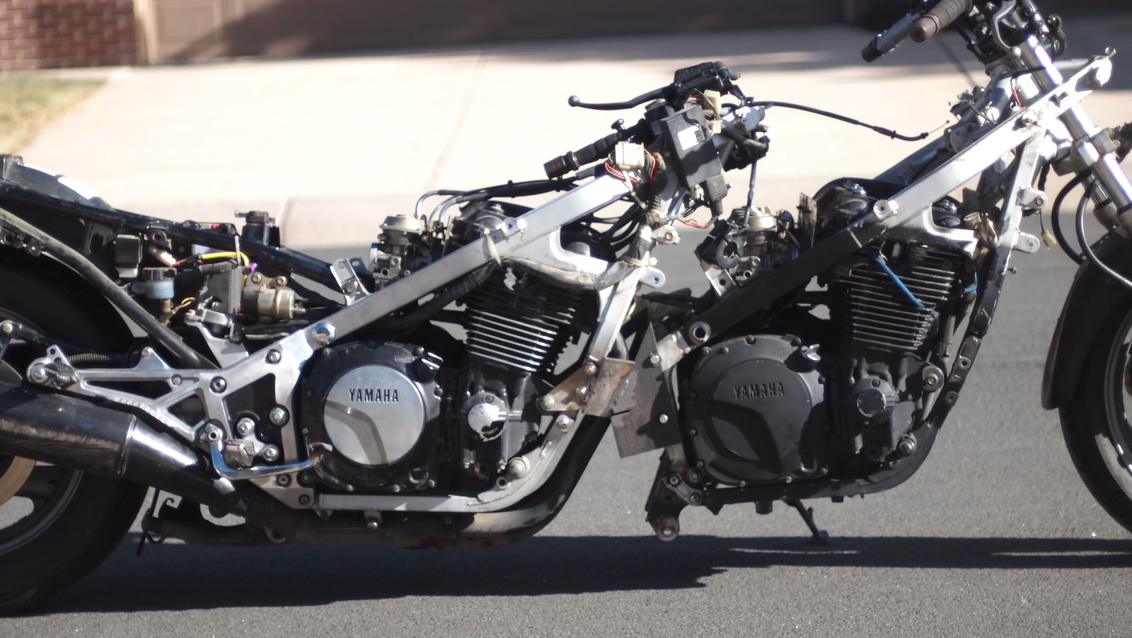

Got her on the ground, rolled her out into the Sun and I'm feeling pretty good about it all.
Sitting and staring at the bike and this photo, I can see where I can steal about 5-6" in length back, which is a big deal for me.  In between the engines, where the steel plate is, I can basically eliminate that and get 3" there.  And then I can move the neck back, to sit above the front engine and that could get me another 2-3" shorter.
It's sitting at 9' long (tip to tail) right now, shorter than The GloWorm already.  But if I could get it to 8'8" or so, then it wouldn't be much longer than my(single-engine) Drag Bike, which I'm perfectly comfortable riding.
