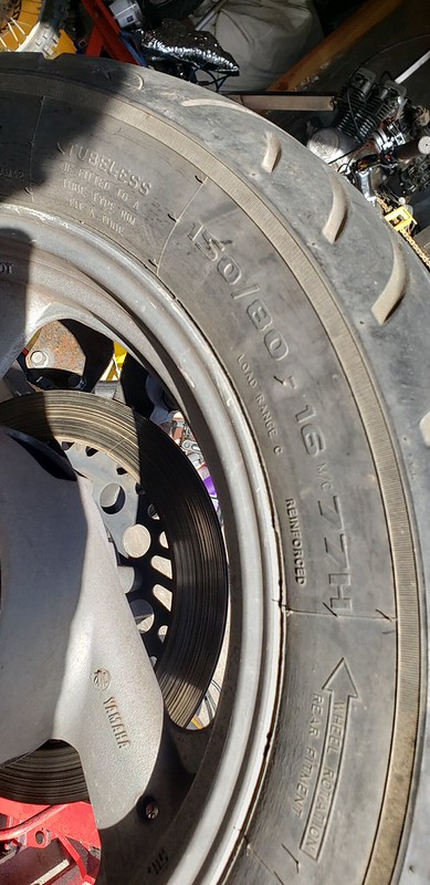

Taking any and all tire recommendations.  I'm primarily going to run AMA at The Bonneville Motorcycle Speed Trials, but -one day- I would like to attend Speed Week or World Finals.  My target speed is 188.007mph.
The FJ came with a 150/80-16 stock, I could probably bump that up to a 160?  The wheel is a 16 x 3.50
So what's out there that will handle the speed I'm looking to run?  Of equal importance would be what tires to avoid, where many folks have had bad experiences with them.

Just about any M/C Z rated tire will be fine at 188mph. Bridgestone is the most popular. The harder the compound the better if you get a choice. Just avoid soft drag racing tires like Shinkos, they will just fly apart. I know that for a fact!

Excellent!  Thank you!
I definitely remember reading something you posted about avoiding the Shinko's & I will definitely heed that advice!

A "W" rated rear tire might be a good idea to give some extra speed rating to account for wheelspin.
Matched sets of Bridgestone Battleaxe sport touring tires is what I have used for the last decade.  No problems with any of them.
FreakhouseCustoms
Thank you for your advice, sir!
I had great success with the BattleAx on a few of my bikes, I will be putting them on "The List"!
