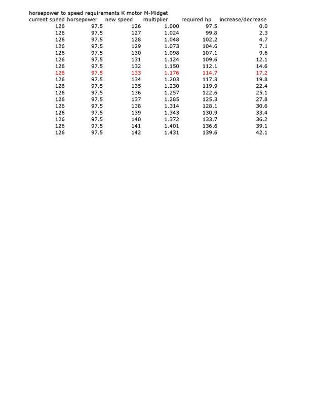

Here is my prediction using the best run from the tractor motor and the rule of cubes.  That is the increase in speed will be proportional to the percentage increase cubed times the known speed with the same aero characteristics.  So the known speed was 126 mph with 97.5 horsepower, the new speeds will be determined using that formula.  Therefore, the new speed, if the gearing is correct will be 133 mph at 114.7 hp.  So gear accordingly to get that speed at peak horsepower rpm as indicated by the dyno results.  Which is why I suggested using the 4.55 rear axle with the same tires/wheels as before.  If you overgear it using the 4.22 rear axle, and the shift to 4th gear drops you down to less than 97 hp, you may not be able to go any faster because you have hit the aero wall as you did with the previous motor.  If you look at your horsepower curve, it is increasing proportionally to the the torque curve which is flat.  But the increase in horsepower to speed increases exponentially.
In your post 7681, using Sumner's spreadsheet, you suggest using third gear to get you to 131.xx mph, but remember that the shift from 2nd to 3rd drops your rpm by 35%, whereas the shift from 3rd to 4th is only 26%.
So even if you wring it out to 9500 in 2nd gear, you'll drop down to 6175 rpm in 3rd at about 85 mph which may put you too far down on the hp curve to recover.  I've been there and done that.

Thinking that a picture is easier to contemplate than a page of numbers, I re-worked a previously generated spreadsheet for use on the "K" that shows power available and required vs. speed in the various gears and other driveline components.  Three resulting examples are on the accompanying attachment.  Pertinent assumptions are noted.  It is easy to change any of the factors if someone has an issue with what was done.
The upshot is clear that this effort is in need of shorter overall "gearing" to likely exceed the existing record.  Or, as was previously suggested--just wring it out in 3rd!
At some point in the discussion I believe someone said an overdrive ratio was available in the trans--can this be an underdrive?  A 4th gear ratio of 1.18 rather than 1.0 would produce about the same situation as the speculated 5.0:1 rear end ratio.
