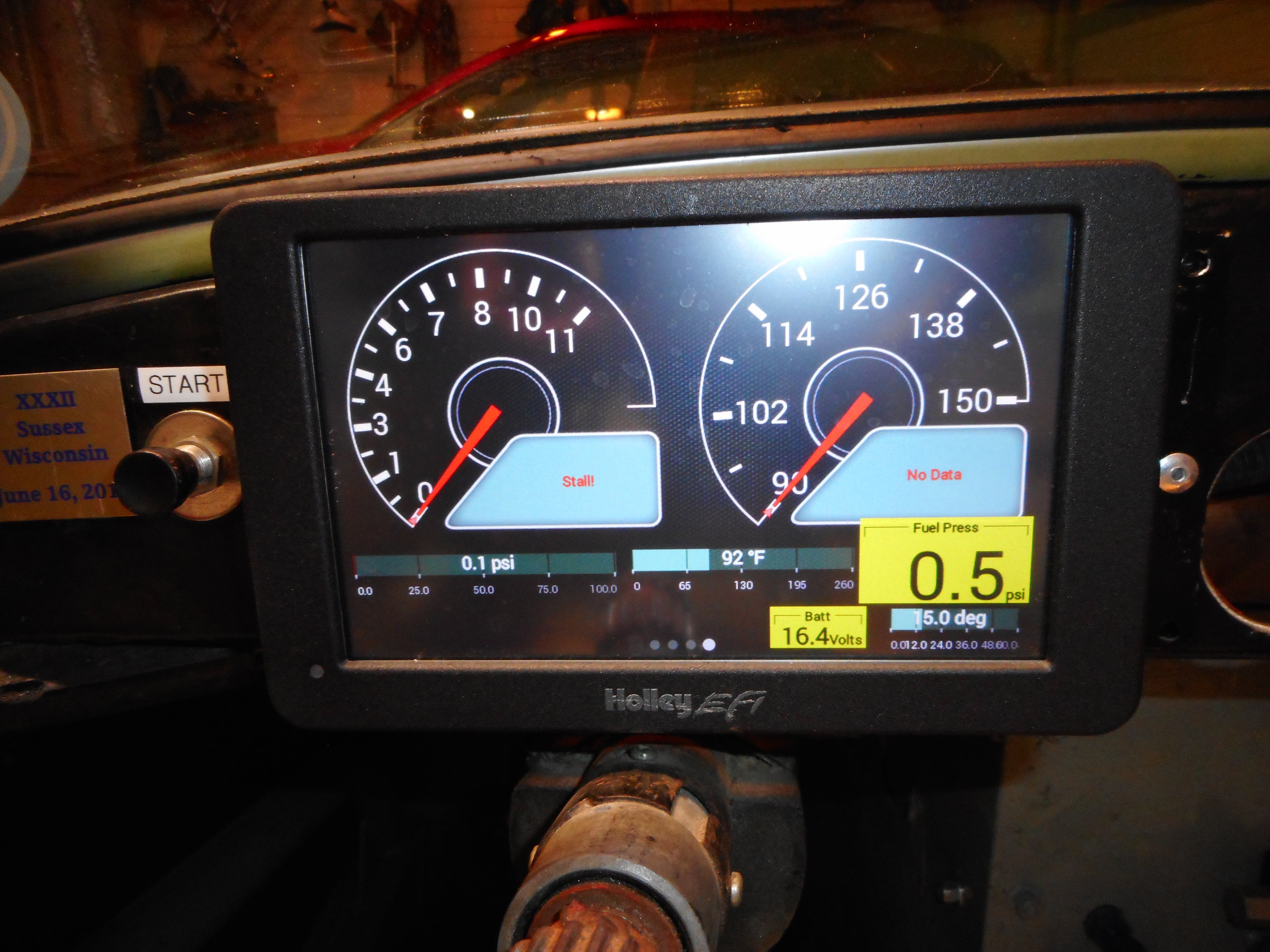

For some reason the Digital Dash - a touchscreen unit with logging and programming capabilities - froze up on me. I get the dash up, but when I hit the Menu button, it locks up and no further touching will open up any further menu items.

All I wanted to do was program the dash. I explained to Chris - the guy on the Holley tech line - what was happening. The touch screen function wasn't functioning, I would get to the "menu" button, touch it, it would pull up a screen with 6 different options and touching any one of them would do nothing. Shut down the ignition, lather, rinse, repeat.
He asked me what the engine was, and after telling him that I'm running a destroked MG/Rover K-series 16 valve twin-cam in an Alpha-N iteration , he tells me this - "I'm not familiar with it, but you'll need to backdate both your ECU and your dash firmware to make these work together."
I felt like I had gone to the doctor, explained my symptoms and was told to stand on the refrigerator, genuflect to the Northwest and ignite my next fart with a Bic lighter.
So I went on line and found copies of the aforementioned firmware programs - and just so you're all aware, flashing a Holley ECU takes about 45 minutes - BACKED UP MY CURRENT VERSIONS AND TUNES - and followed the plan Holley had set forth.
I put the early version of the dash firmware on a flash drive, plugged it in, synced the dash to the ECU, attempted to upload the tune and - the Holley program just shut down.
Wouldn't take the tune, car wouldn't start - and we had worked WAY to damned hard to lose it - so I reinstalled the newer version of the program and vowed to figure out a work-around.
Thank goodness the reboot and monkeying around didn't corrupt the file.
So I'm thinking about it all day - looking at the Holley Forum - poking around on Google. The problem with the Holley forum - and honestly, just about any forum that let's topics be started by outsiders - is that they become so large and unwieldy that search parameters are virtually useless. "Reboot", "backdate", "touch screen"  - yep, there's that word -  and in the context of nothing that's going to help me today.
Until I came across a guy who - completely off topic - said he had used his mouse to reprogram his dash, and that is was easier and faster.
And as certain as I'm sitting here cussing Holley up and down, simply plugging the mouse into the port on the screen allowed me to go in and do every single bit of configuration that needed to be done.
There was an assumption on the part of Chris at Holley that I wanted to fix the problem of a nonfunctional touch screen. But in reality, ALL I WANTED TO DO WAS SET UP MY DASH. I wish he would have simply said, "You know, a quick work-around is to plug a mouse into the USB port and go that route".

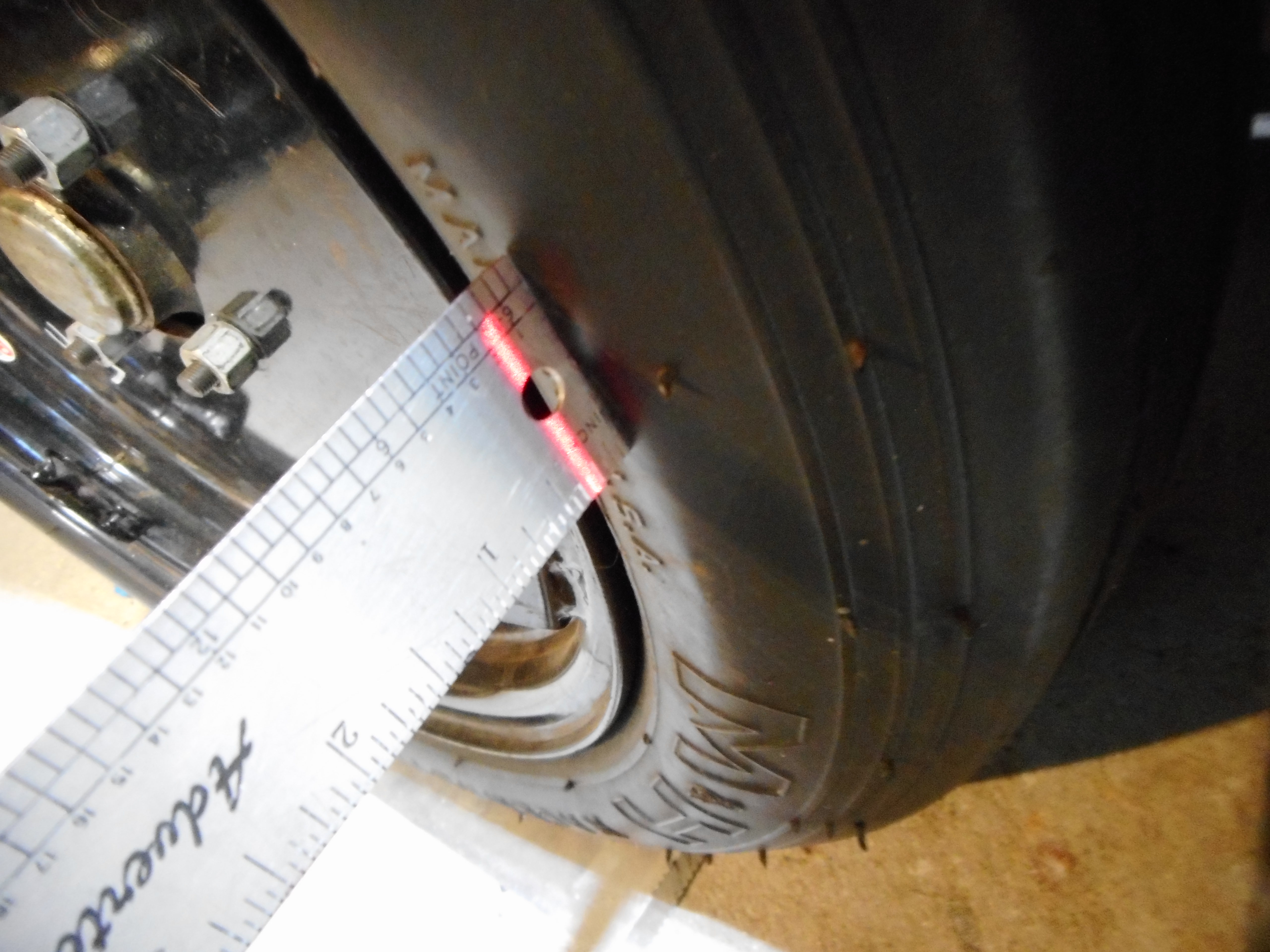

I did an alignment job on it today. Kind of proud of figuring this one out -
I took two pairs of welding magnets and laid a 30" x 1" piece of CRS across it . . .
DSCN0154 by Chris Conrad, on Flickr
and set up my laser-level toward the back, aligning it with the side of the tire - and double checking against the wheel.
DSCN0146 by Chris Conrad, on Flickr
Go to the front and measure the back of the tire -
DSCN0148 by Chris Conrad, on Flickr
and then the front of the front tire-
DSCN0149 by Chris Conrad, on Flickr
calculate the difference, and you've got a fairly accurate assessment of your toe-in. And if it needs adjusting, just take 2 pairs of scrap metal and sandwich some lithium grease between them, and the steering preload and resistance evaporates -
DSCN0152 by Chris Conrad, on Flickr
Factory toe-in is 1/8" - I'm at 1/4" and I'm fine with that. If it had stock 145 80R 13s on it, it would probably be closer than when it rolled off the line at Abington on Thames.

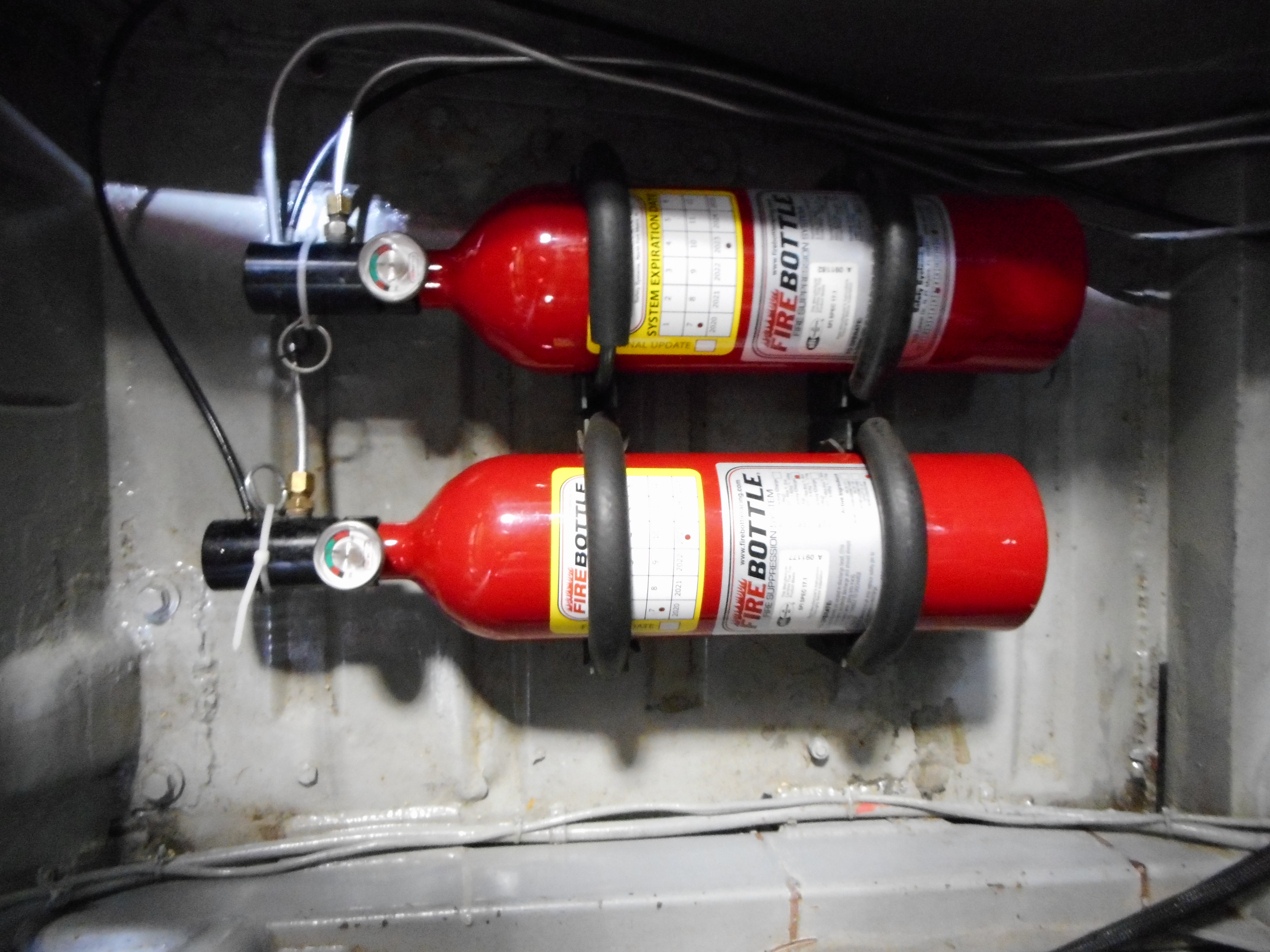

Also got the new fire bottles installed -
